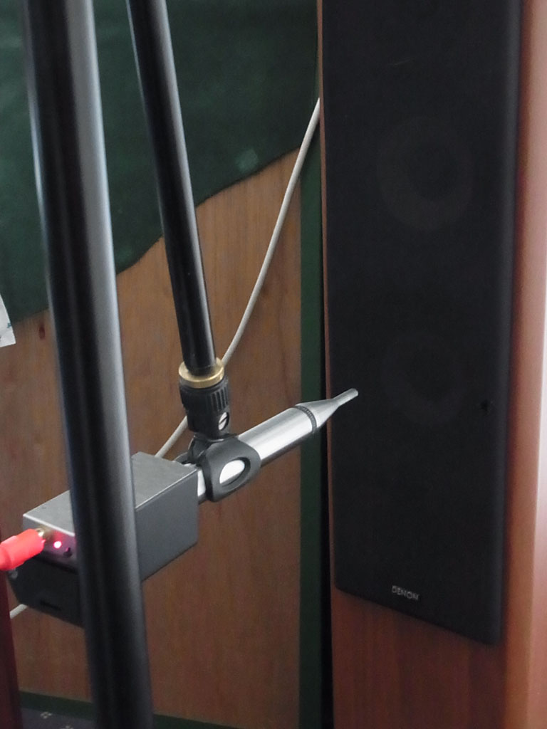

Measurement first results (entirely done with the Parallella)
image #1
- measuring my home-theater speakers during testing (still work in progress so I'll move to the hifi system only after thorough testing)
- microphone is close to the speakers so there is limited room influence
image #2
- measurement of logsweep 2 millions samples 10-21000Hz sampling rate = 44100
- the first vertical line represents a sinewave of 10 periods 11025Hz to determine where the logsweep signal starts exactly (because 10Hz is way too low for the speakers to reproduce anything)
image #3
- the response after convolving the measurement with an inverse logsweep
Measurement sequence
- the Parallella generates the logsweep signal and simultaneously outputs it to spdif and extracts the spdif measurement data from the microphone
- data is saved to SD then analyzed: determine the logsweep start from the sinewave header, do the convolution and save the impulse response to SD

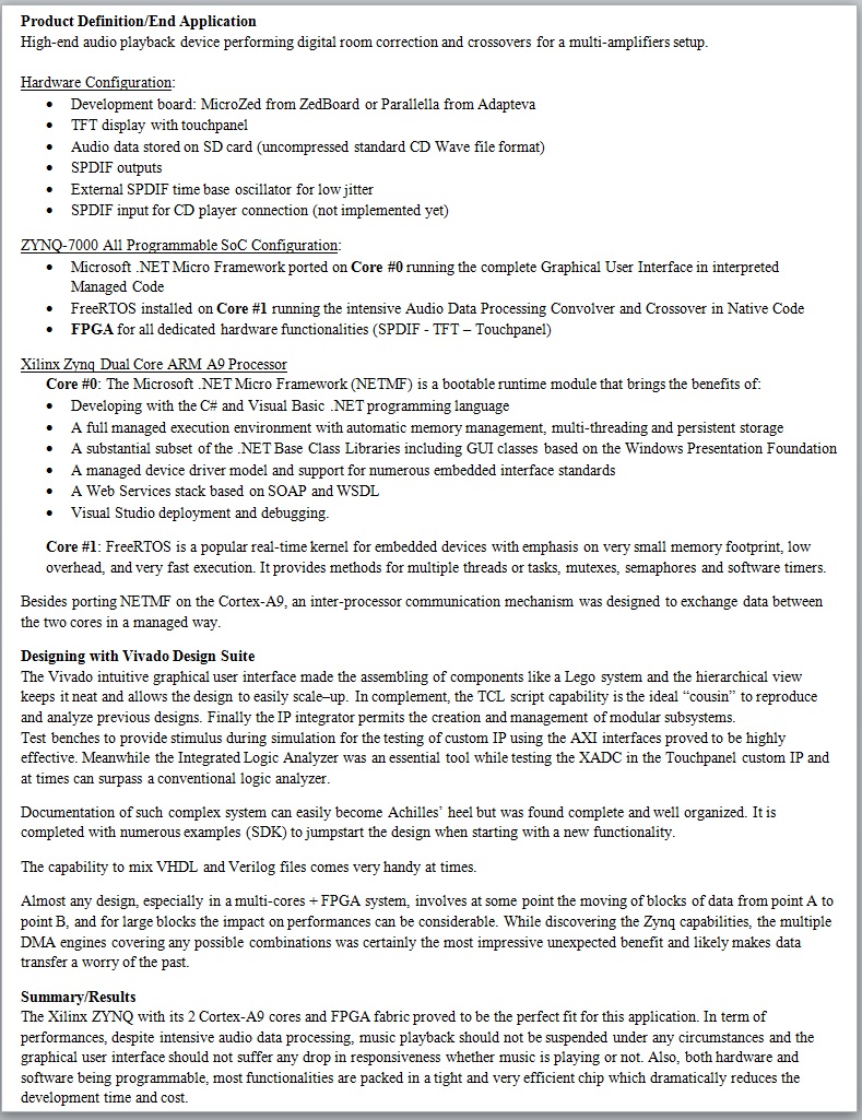

didn't win but here's part of the project description submitted to a Xilinx contest (some references here and there taken from the net).

A word about NETMF
Originally the .NET MicroFramework is meant for resource-constrained devices. However the Parallella with its Zynq, 1GB DRAM,... is everything but resource-constrained and for someone going along the Microsoft path, Windows Embedded Compact (WEC) is probably the logical choice so far for this development board.
But:
- NETMF is free, WEC is not
- NETMF is open-source, WEC is not
With my Parallella board I got the ability to switch back and forth between C# / C / C++ / VHDL, whichever is best to address different parts of a design:
1- NETMF running managed code on one Cortex-A9 core for the C sharp part
=> nice and easy
2- FreeRTOS running native code on the other Cortex-A9 core for the C/C++ part
=> performances and connectivity determinism
3- FPGA programmable logic for the VHDL/Verilog part
=> flexibility + very high performances of hardware programming
=> lower overall cost of the system at the end

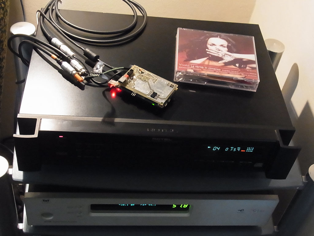

Postby patc » Sun May 17, 2015 12:19 pm
headless version
A CD player SPDIF output is connected to the SPDIF input of the Parallella instead of getting audio data from the SD card. Then the workflow is the same: digital room correction convolution –> digital crossovers –> SPDIF output
I’m using Mike Field’s design for SPDIF Input:
I’m not using a PLL to synchronize the Parallella SPDIF output clock to the CD player clock. Since the convolver works on 64K chunks of audio data, I buffer ahead 64K (=~ 1.5s latency @44100 sampling rate) from the CD player before starting the playback sequence. In that way whether a clock is faster or slower than the other one doesn’t really matter because 64K samples is plenty of room for clock drifting (as a matter of fact during a quick test I found about 1 sample drift per second between the 2 clocks). And anyway, if push comes to shove, I can always use the blanks between 2 songs on a CD to re-align the 2 clocks together....
