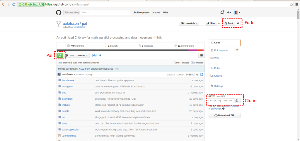

Step #2: Navigate GitHub
For the most part GitHub is self explanatory, but you can see 3 of the most important buttons you will need below.
navigate
Step #3: Fork a repository
To start contributing to an existing repository (like PAL) you must first create your own personal copy. The easiest way is to log into your GitHub account, browse to an existing repository like (PAL), and to click the ‘fork’ button. See Step #2 if you can’t find the button

Step #5: Clone your fork
Downloads the repository from GitHub to your local machine.  There is a copy paste button in GitHub for those of you with ‘fat fingers’ like me. See Step #2 above if you can’t find the button.  Substitute address with your fork of the repository.
Reference: How to clone
 $ git clone https://github.com/parallella/pal
