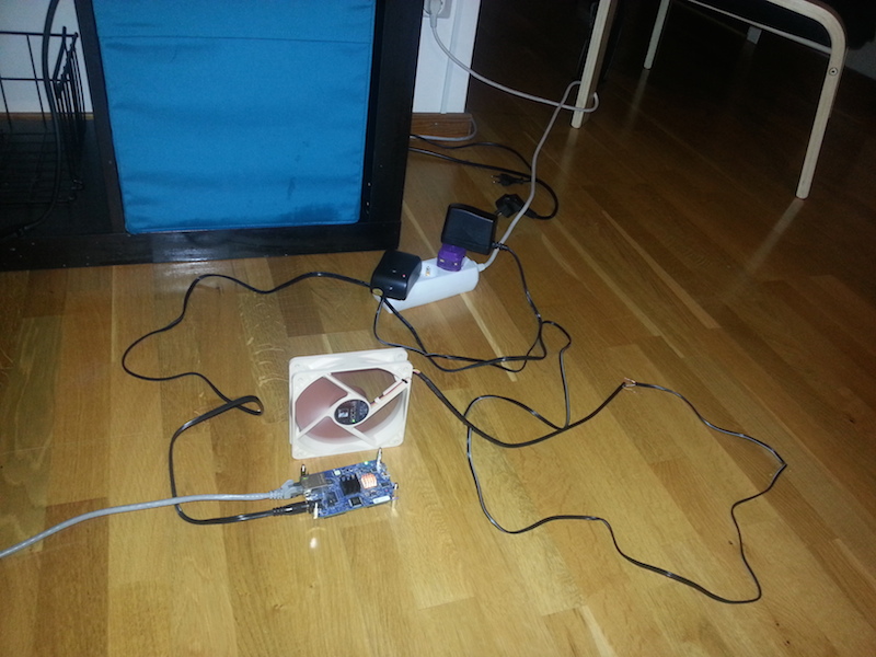

Postby Calle » Mon Mar 24, 2014 9:07 pm
Okay, ztemp says it is running at around 95 degrees Celsius, so it is probably a heating issue (this with only the supplied heatsink mounted).
Letting it cool of and then restarting shows an initial rest temperature at about 65 degrees C, after a few minutes of doing nothing the temperature has climbed to 76 degrees C. After 10 minutes it's up to 90 degrees C.

Postby Calle » Sat Mar 29, 2014 2:08 pm

Which supply and cable are you using? Your own or the one from the accessory kit? Can you show a picture of your setup?
