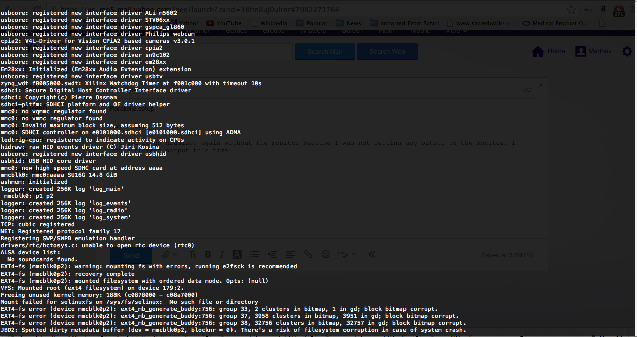

I re-imaged the SD card with the kernel-headless-default and the FPGA file with NO HDMI display and decided to try booting the Parallella headless since I was not getting any output to the monitor. The output I got to the console was this:

Based on this link: http://forums.parallella.org/viewtopic. ... +dtb#p8505 I need to modify the devicetree file. Is that right?

The file system on your SD card seems to be corrupt. Apart from that, the log looks good - if you connect the ethernet port to a DHCP server, you should be able to connect to the board via SSH.
You do not need to modify the device-tree file unless you want to work/login through the serial console.
