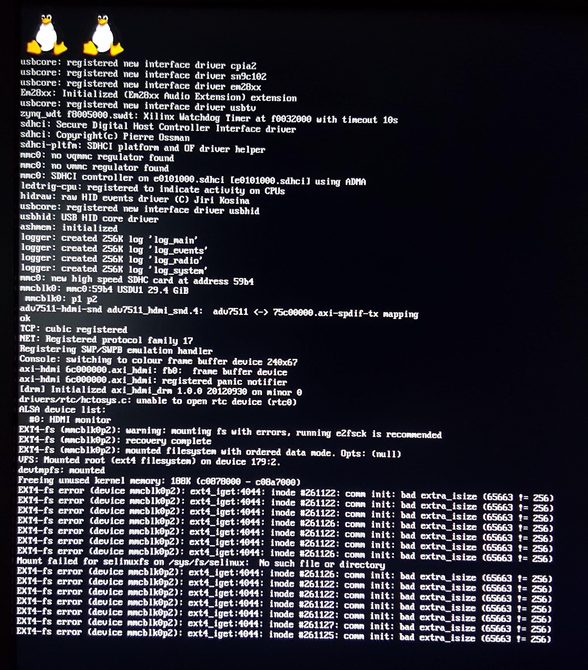

Screenshot of boot messages with ubuntu-14.04-hdmi-z7010-20140611

This does not look like a dead board to me, because the kernel runs and complains about file system errors. SD cards are generally unreliable storage, and the Parallella uses your SD card in a different way than your camera does. I assume that the headless images fail in the same way as the HDMI image, but only a serial debug cable can tell for sure.
I assume that your 32 GB SD card is at fault or that you make a mistake in writing the images. The 4 GB SD card can't work since at least some older images were larger and trying to write would leave a corrupted file system - which the error message shows. You do not need to format your SD card between writes, because "formatting" there just creates a partition table and a FAT file system, which the image will overwrite immediately. It doesn't hurt, though.
I can imagine that you take out the SD card directly after the imager has said that its done, while the SD card itself is still in the process of writing its caches. Depending on how the SD card controller is built (there are huge differences!), this may corrupt the data and explain your error messages. Try a different SD card, a different SD card reader, or leave the SD card in while you reboot your computer after writing the image. You may have had bad luck with both cards, though.
My advice: Try to write the SD card from within a Linux system, and if that fails, use another different SD card with 8 GB (maybe 16, I can't remember).
